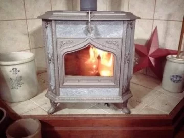

Greetings, Planning a fireview installation and would like to know if anyone has installed one in a corner. My concern is restricted access to the firebox. My other option is moving it over to increase access, but that results in double walled pipe and a wall shield, which gets more complicated and expensive. Picked up the stove used and I already have the single wall pipe. Anyone thoughts?

Thanks. I meet the clearance requirements, it's just a little tight with the side loading door. Looking for input from anyone with this stove or other side loading stove where there's not much clearance for loading or getting around to the side of the stove.
I have a Woodstock Classic in the lower level of my home and it is basically the same stove (size wise) as the Fireview, just no glass for viewing. My side door is about two feet from a side wall and I don't have any trouble loading. If you meet clearances I would think as long as you can open the side door all the way open and the stove is far enough from the corner wall so that a full length split can fit between the stove and the wall you shouldn't have a problem loading.

Go with the double walled pipe anyway. It's good stuff. It also keeps the exhaust gasses hotter so you end up with a cleaner chimney.
