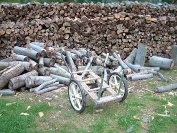

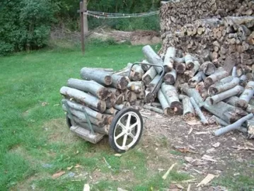

This is a modified garden cart. Has hauled hundreds of cords (full) for me over the past 15 years. This is one tool you need to keep out of the weather when not in use, as mentioned, if you want it to last. But I've hauled wood in all seasons and expect to get another 20 years, or more, out of it. The plastic tub will still sit in the frame easily, so you can also use it like a regular garden cart. I usually just pull the tub across the lawn, however.
Hi Eric,
Do you have a picture that you could post? Sounds like you have something decent and time proven..
Thanx,
Ray
Sorry. The pics don't want to cooperate this morning for some reason. The frame is just 2x4s with 3/4-inch galvanized pipe stakes passing through the studs sandwiched between pieces of 3/4-inch plywood for strength and stability. I anchored the pipe ends to the bottom of the frame with pipe flanges screwed into the wood. The nice thing about this rig is that you can push it or pull it. The pulling comes in handy in all kinds of rough terrain and allows you to comfortably and reliably move wood over reasonably long distances, up small hills, etc. It turns you into a beast of burden, but that's not much different from any other aspect of firewood production.
That looks pretty sturdy and low center of gravity too. Just found this cart at Lowes what do you think about this item?
