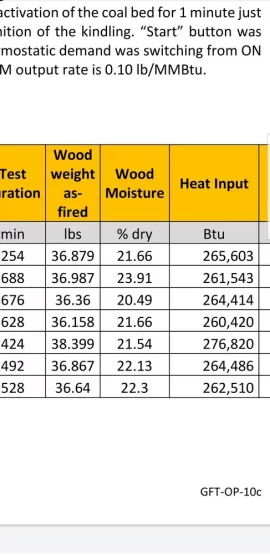

Here is a screenshot from PSG's Caddy Advanced test. While I think the moisture content is a little high even for testing, this shows that it's a more achievable moisture level. The higher moisture can probably be accomplished due to the computer controls, 28% is awfully high.
