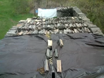

EJ, do you have an '06 pic of your 25-10 cords by chance? I recall last years pictures made my jaw drop...I thought it was photoshopped! ;-)
I'll take one today. I have to fix the tarp this afternoon before it snows.
OK, here you go. That's roughly 27 cords of 22-26" wood. There's eight more in the barn, but I'll probably be able to jam another three in there before the snow gets too deep.

WOW...I have wood envy!
Makes me think of one of those 'big johnson' t-shirts you used to see everywhere. "Big Johnson Wood Co." :lol:

GREEN WITH ENVY!
Eric,
It's hard to tell from the picture. Is there access for a person between the rows, or is it one big stack? If it is one big stack, do you have to climb on there once in a while to adjust the tarp, etc?
Thanks.

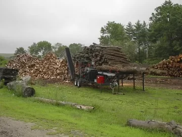

My dream wood opperation
cut split and loaded in a truck 20 minutes a cord
