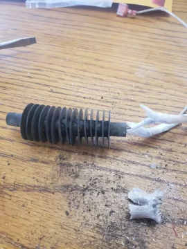

ya know speaking of, had ignitor that would not shut off last year.. wondering why our electric bill jumped so high one month!!
the board had a bad triac or that component i may be spelling wrong...ignitor was just heating away 24/7 for about a week till it gave out..
agree the new updated board I Had to buy was a plus.. Harman P61A.....
1ST real repairs in 8 yrs.... have new burn pot on the way as the heat from the ignitor being on for so long made couple holes a bit larger and thought it was time to replace. put a meter on one ignitor wire in the back with the stove OFF and it was pulling lots of power.
Drove me nuts for a while trying to figure where this extra juice was coming from..
blaming the wife for running dryer too long , ..oven on too long etc...stuff like that before i decided to check the stove..
