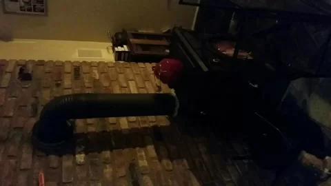

Insulated stainless two wall liner. Approx 16 ft.
You should be able to run it at 350 for sure maybe less you will have to experiment. But still run it up to start with. When you say two wall what do you mean? The light wall smooth stuff?
Flexking twin wall liner with insulation. Smooth inside
I have the same thing. Mine runs about 500 near the stove and 400 before it bends into the wall. Orifices very little creosote and smoke. The more smoke the more creosote.
