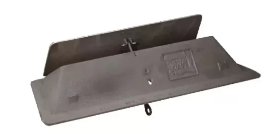

1. What is the best/easiest way to remove the existing cast iron damper, like the one in the attached pic?

I did a very similar install a few years ago. Used Milwaukee 4.5 inch electric angle grinder to remove the fireplace damper. It's a dirty job but fun. Menards has good prices on liner and accessories especially with 11% off sales. My vote- do it yourself, use this site as a guide. Mike

thank you @Mike M. for the recommendation. I think the grinder will do the trick. I also checked Menards but they don't seem to have the flexible liners. any other suggestions?

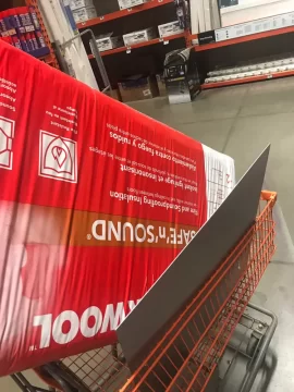

got these yesterday at home depot [Hearth.com] First Post - Napoleon 1402. the 16 gauge ss sheet seems like its going to be a pain to work with. what are you guys cutting this thing with?

got these yesterday at home depot View attachment 230968. the 16 gauge ss sheet seems like its going to be a pain to work with. what are you guys cutting this thing with?
Yeah you dont want to use 16 gauge and you dont need stainless. Return that and get some 22 or 24 gauge galvanized.
4.5" angle grinder with cut off wheels. Then deburr edges.
A good jigsaw with good metal blade will also work, albeit slowly on SS.

is 30 gauge to thin? thats what lowes had, didnt see anything in home depot
I would say yes. 22 is a little heavy to work with. 30 would be too light. You have a great chance to crease or bend it getting it into place.
Yes, 26ga is what I'd recommend. It's easy to work with but stiff enough to not be flimsy.
ACE Hardware or you could try a local HVAC company that bends duct.
