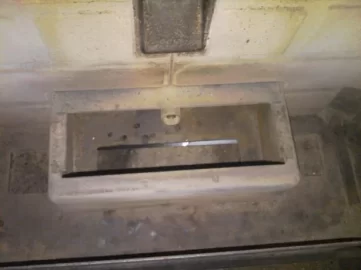

Below is a pic of under my burnpot which shows that 1/8 gap clearly with a flashlight for illumination.
So that is not the issue.
Also the only thing I found by blocking the square hole in the Intake Plenum was when the weather outside has a very high dew point there is more caked ash in the burnpot and that is why the square hole is there. So I am thinking that the square hole does not need to be blocked in the shoulder seasons.
I did find by keeping the burnpot clean and a little spray graphite also keeps the caked ash from forming.

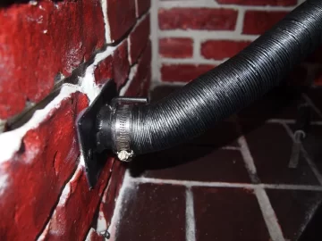

How did your OAK come out? Below is a pic of my carburetor Air Filter Pre-Heater hose. :-)

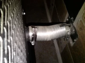

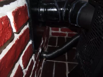

It came out great let me tell you its like it was made for the damm Job....now im experimenting with pellets let me tell you theres alot of junk out there bought a few bags of different kinds and when i tell you theres some real garbage out there
some pellets leave so much ash its insane so far the best ones ive picked up are the Greenegold pellets there alittle more expense but low ash and my stove doesnt get black like the cheaper brands.....thats why i havent bought a ton yet trying different brands before i buy a ton or two...Don i painted the pipe with the high heat paint to match the rest of the black.......looks just like your setup....

Great Job !!! Very Nice! Thanks again for more pics. :-)
The OAK setup now looks exactly like mine! Is that the fresh air damper lever I see on the wall?

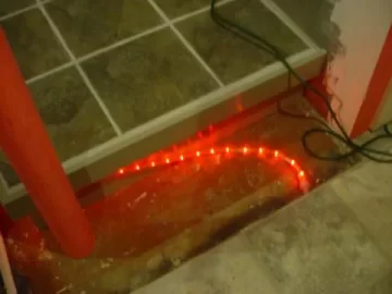

P.S. I installed some Rope Light in the hearth and back wall!! See pic

Yes thats the damper level i bought the oak from the stove dealer when i open the box saw the damper level thought it was pretty cool.....i love your setup your stove looks like it sits on a throne.....Nice lighting effect...very nice
