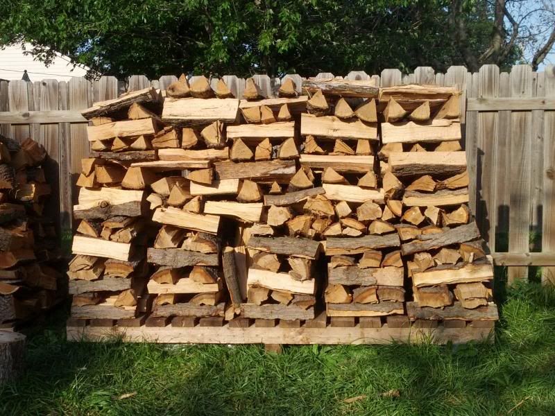

This is what I managed to cut, split , haul and stack this weekend. My only worry is I was hoping that this would be my only source of heat this year ( heated with electric oil filled heaters last two years $$$$) but I am thinking my wood will not be dry enough by then. Especially since I was looking at a vapor fire. May be a pellet furnace in my future for this year. I will be heating 1500SQ FT and it is one story but worried if I go with a pellet stove I wont get warmth thru the whole house and have our first child due in Dec.

Sorry for the rambling just excited to finally break into wood burning.
Look for pine, maple, or another soft wood and it will be dry by this winter. You can also rig up a DIY solar kiln to get that wood nice and dry. here is a link to a Virginia Tech Site about doing just that. I have one rigged up with little more than a 10x20 black plastic tarp. (broken link removed to http://sbio.vt.edu/about/extension/vtsolar_kiln/)
I'm letting the maple I have air dry and I have about a cord or so of oak tented up, hoping that I will be able to burn that this winter.

another type to look for is tulip poplar as common as it is in the southeast. there's a lot of it, and it's straight/easy to split.
i'm not strong at identifying wood, but what kind do you have there? some of it looks like red oak to me.
that Dexterday is a heck of a guy, ain't he? First class, all the way....
looks like a nice mix of locust in your stack there, I'd be taking some of Augie's and wes's ideas....get some softer, faster drying shoulder season wood. Silver maple, red maple, tulip poplar, pine, and cedar....all good stuff, and when split small to medium (4x4" to 5x5") will dry out quickly, most likely in time for this winter.
Yes he is for sure a first class guy. I will start looking for soft woods seem to be having problems with my wood id a little but I will be working on that.
lots of good information online. and lots of good field books out there that can help you. Also, I think there is a tree ID app for your smartphone.....

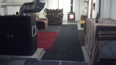

As for the wood.. Look for the species stated above. Dead standing is always a help.
If interested in pellets? A pellet furnace can be nice. I am a little biased and yes you have to buy pellets. But I also spend a lot of money on saws, splitters and the like. I use between 2-3 ton of pellets a year and about 2-3 cord of wood a year and keep 3,000 sq about 74*-76* all year :) Withna pellet furnace, that means the ENTIRE house is that warm. Not just the living room and bedrooms are 66*.
So I spend between $350-$475 a year on pellets? I spent 2 times more than that on my Ms460 mag. To each there own I guess. The wood helped me reduce my pellet consumption by about 1.5-2 ton a year.
I love wood and pellets for different reasons. Either way, it beats the $3,600 a year I was spending on LP. So even if I spend some money on equipment? I still make out in the end.
Cheers my friend. Was a pleasure to deal with you.

Devin, the first thing I'd do would be to get those splits smaller and also stack only one single row on the pallets. Most of your stacking is great because it is not really tight which lets air move through and that is the biggest key to drying wood. Good luck.
Good idea with the pallet & 90° brace.
Sun & wind for drying wood, more of each, the better. Wind (good air circulation) most important . ;)
Hope to finish out that stack this weekend. I will be looking for some softer wood and making my splits smaller. I think the pallets will work out pretty well ends are solid have a firework wholesaler next door so I just run the ATV over and toss as many of the good ones as I want on the trailer so I will make them work. Thanks to everyone for all of the helpful advice.
Looks like a good start. You might want to sort the wood a little as you stack, especially if you want to burn some of it this coming winter. The upper part of your pile looks a lot drier than what is under. Separate what will be good from what won't be and your fire will be a lot warmer. Some extra space under the pallets will help the bottom layers dry much quicker. If you have access to a lot of pallets double them up. Anyway, just keep stacking it up and three years from now it won't matter.

Pretty much just re-hashing what's been said here:
Get a moisture meter to help until you get the feel for dry wood. Single-row that stack, separating out the lighter stuff that resonates when banged together, and re-splitting the bigger ones. As BwS (Dennis) says, wind is your friend....stack loose. If that BL had the bark off when you cut it, a lot of it might be pretty dry. Cherry will dry pretty quick if not split too big.
Soft Maple and Poplar are the quickest-drying stuff out there. Even if cut fresh, it should be burnable this winter....sooner you can split and stack, the better. You might contact a local tree service and see if they will drop a load off free, or you can pick it up if you're quick, when they are nearby. Have them cut to 16" if you don't know what stove you're getting yet.

Devin86, what you could do this winter is, sort through the wood as you bring it in to burn. Toss the stuff that seems heavy to the side and trade it to Blue for some stuff that's ready to go. But I'm tellin' ya, if you get a bunch of soft Maple split and stacked soon, you'll be good to go. You'll have enough dry stuff to start on, and the Maple will have a couple extra months. You may have to monitor your chimney liner for build-up more often (once a month starting out) and take appropriate action. Once you have dry wood, a check halfway through the season should be plenty.
Huge thank you to Bluedogz and everyone else I think my current plan is to go with a low buck used pellet stove this year and maby next year while I continue to build up wood I really eventually want to end up with something forced into the duct work looking heavly at the Kuma Vapor Fire it hase been very wet here recently so I have not been able to cut much more but I will stay on it all summer and put all of the wonderful advice I have been given to work.
