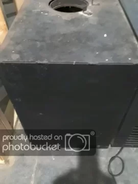

The back:
[Hearth.com] First year with wood insert, not really helping . . . please help!

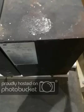

Manufactured 10/13/2009. Newer than both my cars, and house.
