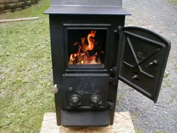

You have the whole line up and they can be addicting and look at this baby one so cute..
They stole that picture of my early Baby Bear door! It was ready for paint, and I propped it up on the quart can I brushed it with. You can just see the can under it at the top. All the info you find on the net came from here. Most of it is inaccurate, they can't even copy things right.
[Hearth.com] Fisher mama bear 6inch damper I had it shipped from Idaho to PA. Here it is when it arrived wrapped in a baby blanket.
[Hearth.com] Fisher mama bear 6inch damper The finished door, note plywood floor all the pics were taken on.
[Hearth.com] Fisher mama bear 6inch damper The finished stove. (The floors in my house still aren't done) The doors without trees were the very first stoves with 3 piece tops, not bent tops. Only a few fabricators made them out West before licenses were sold moving eastward. By then changes had taken place with their development, so these are not found on the East Coast.

The stolen picture I’m referring to is the early door without trees on the plywood floor. That is my door on the stove I pictured.
[Hearth.com] Fisher mama bear 6inch damperReady for paint with air damper pipe cap removed.
The first stoves were made with a 2 inch pipe cap for the air intake control. Bob Fisher's father, Baxter came up the idea of a cap with fins to turn with your foot. He patented it as the air intake damper. It was known as the EZ-Spin air damper.
The stove is in my collection and is not fired.
