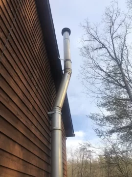

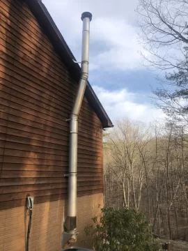

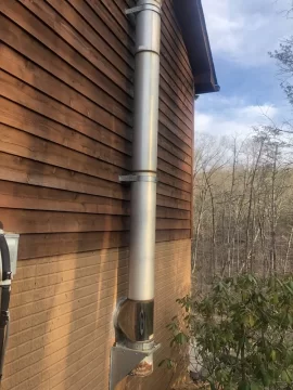

Awesome, I really appreciate the help. In your opinion, what do I need to run it most efficiently and safely. At the end of the day I want it to heat my home and not burn it down haha. I’ll attach pictures of the outside. Thanks again for getting back to me, this forum is great, tons of information

Some observations. Your basement appears to be cast in place concrete walls with a large portion above grade. Typical construction. The insulation appears to be a R-10 poly scrim vinyl which is attached with pins to the concrete. The wall behind the stove appears to have vertical framing, probably wood. Not many metal studs used in residential. The drywall has tile attached. There are others on Hearth that can address the distance required from the stove to this type of wall construction. The tile will get hot and transfer heat thru the drywall to the studs. If the stud cavity is insulated, the studs can become overheated.
The reason I'm making these observations, is heat loss. If you increase the R value of your basement walls you will have more heat to go up to living area. The wall behind the stove would be the place to start. The back of the stove and the stove pipe will radiate heat thru that wall and to the outside.
So even if the existing setup is "according to code" you can reduce heat loss and reflect more heat off the wall.
The transition of 6" to 8" pipe does not seem like something a professional with knowledge of wood stoves would install. The pipe on the outside looks to be insulated 6" inside, 8" outside diameter. I'm basing this on the fake brick lines on the concrete wall. The cleanout at the bottom is corroded which tells me condensation is forming in there. It is worth the time to open this up and inspect.
If the outside pipe is 6" inside, I would take the inside pipe apart and find out what pipe goes thru the wall to the outside T. You may be able to change to 6".
From the pictures I can't tell if the top of the chimney is the required horizontal distance from the roof. And I would inspect the straps attached to the wood siding and face board. You don't want the pipe to blow off the side of the house.
