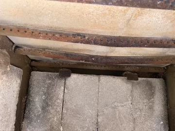

I've got a Regency i2400 and it's eight or ten years old. It's has been fantastic but I just noticed that one of the burn tubes is sagging. Should I replace it before burning season really begins or can it wait until spring? Also, if I'm replacing one, should I replace all of them? Thanks!

I'd replace the front two, they look the worst
Replace them all under warranty

Thanks for your help! I’ll make a call this morning. With the age of the stove I didn’t even consider warranty.
Is it likely to be an easy job?
Yes very easy. And as long as your ul tag behind the blower is still legible it should be covered

Update! Yesterday, I called the store and they said as long as I had my receipt I should be good to go. Since I bought the stove more than 15 years ago and my paperwork is more bin than file, that was going to be a challenge. Right before I began my search the stove shop called and they found a copy of my receipt!
I went and picked up two burn tubes (along with a photo copy of my receipt) and had them installed in just a few minutes. I am very impressed with the warranty response from both Regency and my stove shop.
(For anybody reading this and wanting a "how to" I put vice grips on the burn-tubes and hit them reasonably hard from right to left to remove. Inserting was the same but hitting from left to right.)
Thanks again for all the great advice!
