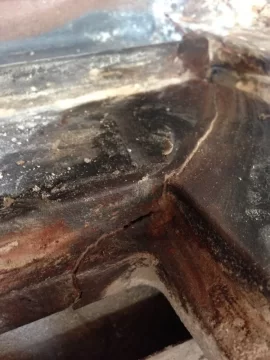

Thanks for this. I had the stove inspected and cleaned before the season started. The previous owner did over fire the stove at some point, I expect by doing exactly what you said - cracking the ash pan door to get things started. He probably forgot about it and the cast grate on the stove floor got so hot it actually warped ( it is an arch now about 1.5 " high). I've ordered a new one. The air burners and vermiculite plate above them seem ok as does the rest of the stove. Everything appears tight.

Before lighting the first fire, take a damp rag and clean the firebox floor for inspection. Look for any hairline cracks starting in the corners of the grate well. This is what you are looking for.
