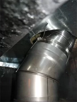

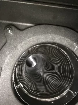

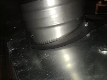

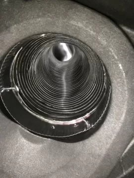

Hey all,
So I'm working on hooking my new Clydesdale w/ a 6" flexing pro from chimney liner depot.
My question is this in far enough?
I've pulled and pushed and pulled some more and just can't seem to get the angle right. Not a lot of room between the block off plate and top of stove to get any good flex. The front of the collar is all the way in to the lip. Rear is in but not real far.
Thanks for your thought!

I think a 15 degree elbow would work perfect there but no it is not in far enough
A stainless welded elbow works a treat.
