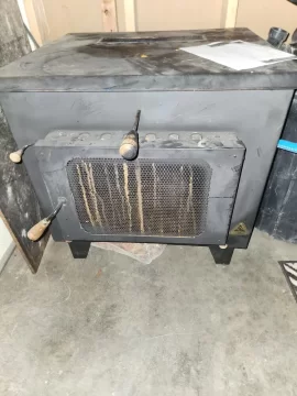

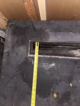

Hi I'm new to the group. I recently was given a wood stove without a flue collar. The opening on top was rectangular and I couldn't find an adapter to fit. I made one out of 1/8" steel. Will this be thick enough? Should I weld it to the top of the stove or is there a better way to connect it? Thanks in advance.
