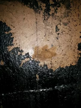

I was getting ready to clean my flue today and noticed what appears to be a hairline crack in my flue liner running vertically down the tile. It is an external flue, where this is it is about 2-3 feet below grade. It is right inside my thimble on the back side of the flue.
I am thinking that it is a crack, but what it odd is I can't even catch a finger nail on it. Yea I know I have a bit more cleaning to do, I took the pic when I first removed the pipe from the thimble when I was getting ready to clean.
It is really tight, like I said can't even catch my fingernail on it.
Thoughts?
Since I can get to it could I seal it with some refactory cement? or high temp silicone?
Is it something to worry about?
I could reline with a stainless steel insulated liner which would help with stack temps and the external flue. If I can avoid that safely I would prefer avoiding it for now.
Any help appreciated, thanks!

Absolutely a vertical and horizontal crack there. And chances are you probably have more cracks elsewhere in the liner as well. You can have it scanned to confirm that if you want but those cracks alone is enough to call for a new liner.
If you can't get a fingernail in it, ya ain't gonna get furnace cement in it. And since that is obviously right where the exhaust blasts into the tile silicone is totally out of the question. It goes "poof" at 800 degrees. With that much stage 3 creosote that close to where the exhaust is burning off just that spot, I would hate to see what the rest of the chimney looks like.
Get that stuff scrubbed out of that flue and line it. Do not line it with that stuff still in there.
Thanks for the replies, oddly enough the rest of the flue cleaned up nicely. The top part is fine. Most of the stage 3 was around the thimble and lower. It was clean when I brushed it mid-winter. I picked that up from mid-winter to spring. Been burning wood for 20 years, never really had that issue before. Late winter was mild and wet, so sure I wasn't burning it hard enough.
I don't think that is a horizontal crack, just the vertical one, I see what your referring to, might just be the picture. I will check that tomorrow though to be sure.
Again thanks for the feedback.
I could be wrong but it sure looks like one to me. But regardless even if it is just that one crack it is enough to call for a new liner. There really is no way to fix it and it may be tight now but it is not when the liner gets heated up.

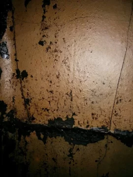

So I got the flue cleaned up a bit today, found another vertical crack in the same tile in the liner as well you are correct bholler that was additionally a horizontal crack. The vertical cracks do extend into the tile below. I attached a picture below. So I have to move forward and get this corrected. I have a few questions that maybe someone can help with.
