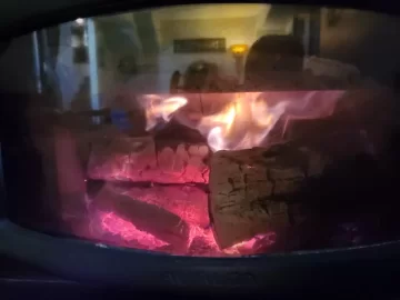

Some of my splits are smaller. But this is how it looks settled down with just a little smoke every one in a while

You mentioned a couple of times it gets too hot Do you have a thermometer? Sometimes people feel it is running too hot, but in reality it Is still in the safe zone.
I use a ir gun and check at the base of the liner. I try to keep it under 400 at this point usually around 330-360.

If that temperature was being read 18-24” up the flue pipe then it’s nice and warm. That same temperature on the stove is too cold and you are smoldering it.
