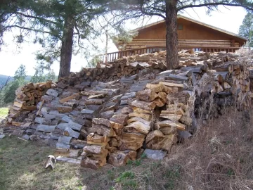

I live in central Montana at 5,000 ft, next to the continental divide. I have many years worth of pine stockpiled. I stack it close together in a big clump, because it is all cut dead and dry. I have never covered anything except what I will burn in the coming winter, mainly to keep from having to dig through the snow to get to it. Our snow tends to be quite cold and dry.
The third picture is an old gray split that has been on the pile for a number of years, showing a moisture reading 14.2
Admittedly, we have a much, much drier climate that you folks back east. Summers are extremely dry and any moisture they pick up is driven out by fall, so this may or may not work for you.

Thanks for the input, this is more in line with the info I'm looking for.
I know the pros and cons of top covering and what to use, etc., and the stacks I am talking about would not be used for the upcoming burning season but one or two years down the road. I was looking for info from those who have had their stacks covered under snow (as in completely covered - top, sides, etc.) for the duration of the winter and if it adversely affected the wood for future use.
Yeah, you guys and your 'dry and arid' winters out west. We have the hardwoods but we sure have the humidity to go with it.
A lot of territory west of the Cascades to the Rockies is high desert and very dry. We'd never get away with stacking on the ground here.
True, the Pacific Northwest is a whole different animal. You're probably like us in that if you were to stack directly on the ground, the bottom layer might as well be in a swamp.
Still, aside from the stacking on the ground, if Montanalocal's pine has held up that well after several winters of being covered in 'dry' snow, I think I will be ok. I may just leave the future year's wood in rounds (as I did this past winter), stacked off the ground, and then CSS in early spring to let it season. (Except for any oak I get, that will get split and stacked separately to start it's many-year drying process.)
