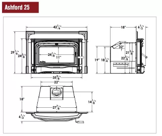

Need full fireplace dimensions (H & W, front and rear + depth top and bottom.) in order to suggest an insert. There probably are several that would work. Could be good to see if the BlazeKing Ashford 25 fits and in non-cat the Enviro Boston would be worth a look.

28"h x 32.5"w front
28 x 21 rear
23 deep at bottom
16" at top
I think/thought I wanted stove stuffed into fireplace, now as of like 2hrs ago I'm thinking insert! I was surprised how well my little stove worked. So my thinking is that stove worked well, let's get something more efficient that can heat more sqft. Don't like the fan reliance but realize there may be compromises necessary.
I think that ashford 25 would fit, thanks for your input!

Thanks, I'm leaning towards the ashford 25, possibly the sirocco25, but ashford is nicer looking and I believe has a cast iron jacket vs steel. Either way I don't think I've read any bad things about the whole BK line!! The fan is the only thing that worries me, I'm curious how it does heating wise without fans on. All the long burn times are exciting to hear, mainly for the overnight.
