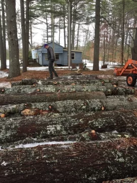

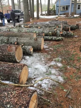

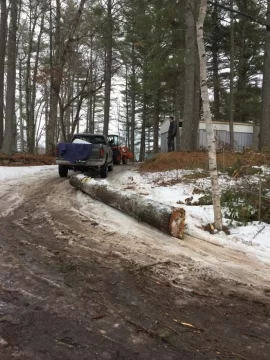

clearing some land of many large pines, over the course of fall to present. With snowstorms the place is a mess/maze of downed trunks, limbs, etc. I’ve been cutting the logs to 12 or 16 foot lengths as we plan to sell them to a lumber company. Long story short, I’ve gotten my primary saw pinched more times up there, it’s ridiculous. So, I finally picked up a backup saw. Stihl Ms 250. I’ll post pics later, here’s some of the work site.

Nice! Skidding with the pickup?
Yes, pickup and the tractor in some cases haha. 01 Ram 2500 diesel. We took a winch off a racing trailer that’s rated for 5,000 pounds, and welded it onto a steel housing that slides into the trailer hitch. It worked pretty good.

Get a couple of the plastic orange wedges, and find some boards about three feet long to slip under the log on either side of the cuts. I worked up about 10 cord this way last year out of a bunch of 3' diameter logs, never needed another saw (but had them if I needed them!) Try it, you'll never go back.

You're gonna love what a difference those wedges make, and so simple. Just stop cutting about half way, stick the wedge in, pound on it to set it, pick the saw back up and continue the cut.

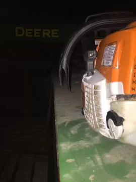

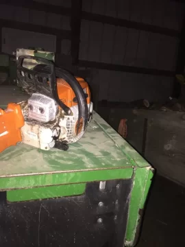

Yes a second saw is really nice to have especially when you do something boneheaded like set your saw on the spare tire & get to rammy dragging a log out of a brush pile. Nothing quite as satisfying as watching your saw in slow motion pop off the flatbed & splaton the ground thru your mirrors. :confused::rolleyes:. Luckily it just busted the handle.

Just a broken handle in that situation is great. Stressful during, though.
My buds son set a brand new 039 behind the truck tire...he didn't get off so lucky....lol

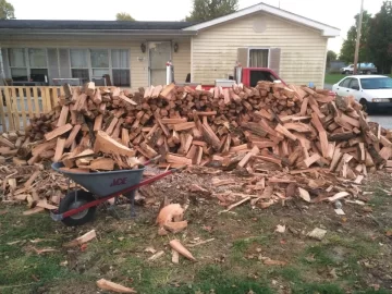

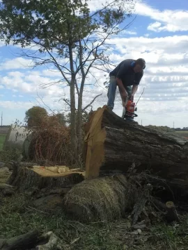

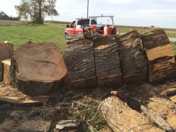

I did not stick a saw one time processing this big dead oak using plastic wedges....stayed warm a couple years off of this one..
