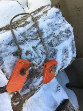

I use wedges all the time as insurance. I also have two wedges on a piece of nylon cord about 2 feet apart. If it’s anything of significant size I set both wedges. one at about 10 o’clock position and one about 2 o’clock position. I found that on larger logs a single wedge at top can still pivot in the horizontal plane about that wedge and bind. if you have two it can’t pivot and bind.
Usually I just set them by hand smacking with the palm of my hand because you’re not trying to wedge open a closed cut just trying to prevent a cut from closing
The cord makes them easier to carry but mainly if the cut opens up and the wedge drops down quickly and touches the top of the running chain it doesn’t get launched into left field. the rope keeps the wedge from dropping down also as it is wider than the cut. it also keeps it from dropping onto the ground on the far side of the log so I don’t have to reach or bend over down to find it when the cut is done.
The wedges in the pic had plenty of use before the ropes. They often dropped down into the cut quickly as it opened up, contacted the chain, left orange shreds, and launched 10 feet into the weeds. I should replace them because of tghe ragged edges, but they work ok as still narrower than the kerf. I would not use them for felling of course.
I make my cut, move to the next location, drape the wedges and rope over the log next to it and then start cutting. idle, hold saw handle with right hand, set the far wedge with my left hand, set the near wedge with my left hand, and resume cutting. very fast just five or 10 second pause.
edit: add pic
The cord makes them easier to carry but mainly if the cut opens up and the wedge drops down quickly and touches the top of the running chain it doesn’t get launched into left field. it also keeps it from dropping onto the ground on the far side of the log so I don’t have to reach or bend over down to find it when the cut is done.
I double wedge the big boys as well in the same manner...most of the time I have a helper setting wedges and we stay in tandem and knock a big log out pretty quick.
