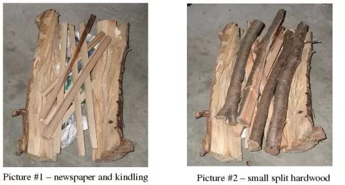

I've been working on this for a long time, and I figured it's time to share where I'm at and see if anyone can help me improve. At this point I can pretty consistently get secondary combustion going four minutes after lighting, and I've figured out how to reduce the smoke that's generated during that time.
Seems to be a few important things:
- Not too much paper or kindling
- Leave top door partly open to provide more air and reduce smoke going up the chimney
- Channel fire toward the nozzle
Here's my process, from my Operating Instructions (http://www.nofossil.org/orlan/OperatingInstructions.pdf):
1.Take two pieces of light wood (pine or poplar). Make a channel over the nozzle with a 'V' shape if possible. This is to concentrate the starting fire over the nozzle and help burning pieces to fall towards the nozzle.
2.Crumple / twist one full sheet of newspaper and place on channel. Put a few small pieces of dry kindling on top – mix of hardwood and softwood if available. Don't use too much. Should look like picture #1.
3.Split a piece of buckthorn or other small hardwood – halves or quarters, and place on top. Add a couple of layers of small sticks. Each layer should be at a slight angle with spaces between pieces. Pieces should not rest too much on the large 'channel forming' chunks. Should look like picture #2.
4.Add layers of successively larger wood until the firebox is about half full or more. End with wood that's about 3” diameter.
5.Open bottom door. Light newspaper with long match or torch.
6.Watch fire start. Adjust top door to prevent smoke.
7.When fire is roaring (flue temp 275 F), close doors and damper, turn on controller

I'm glad if this helped. My biggest issue with this system has always been the huge cloud of smoke at startup. I'm hoping to discover even better techniques. This one is at a level now where I can be pretty confident that others scan be successful starting my boiler.
