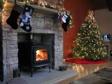

Yep that can be really attractive too!
(broken image removed)
I like the framed picture. :)
