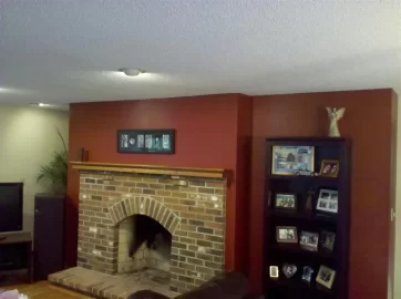

Im trying to decide weather I want to put a free standing wood stove inside my fireplace with no surround or an insert with a surround.
I was hoping you guys could give me some pictures of your wood stoves inside your fireplaces or your woodstove inserts to convince me which way to go. If I go with an insert im leaning towards a hearthstone clydsdale as i love the large viewing window, its pricy tho.
attached is a picture of my hearth.

Nice Hearth. With the rounded top of your hearth I think you might have a tough time finding a surround panel for the insert that will accomodate the arch. (Love your setup) If I were you, I would go with a freestanding stove, as it looks like you have plenty of clearance for one...might need to place it half way in or more to meet the 18" clearance for the front of the stove.
Also, a plus on having a stove vs an insert, is that the insert will need a blower, and this can be tough when the power goes out.
I have an insert, and although I love it, if I had the size of the hearth and clearance you do, I would go with a freestanding model.
Again, just my opinion. Good luck
That's beautiful, I would think a hearth stove (not IN fireplace but on hearth in front.) A Jotul on the hearth would be really pretty.
Or, you could put an insert into the fireplace and either leave the surround off completely (I have a thread on here with a whole bunch of pics of this) or have the surround custom-cut to fit inside that pretty arch.
Yah, great setup. I would def put a free standing stove in there. I think it'd look great and be an easier job.

+1, I totally agree. The brickwork is too nice to cover up, let it be seen. Place a stove on the hearth and enjoy both.
With that size fireplace, i would think a hearthmount stove. It depends if you are going for looks, or serious heating. If you are getting into serious heating, i would get a hearthmount stove. I went with an insert because a free standing would have required some serious mods i didnt want to get into. That being said, there are some very nice looking free standing stoves that will look like a piece of furniture, just wont look integrated into the fireplace.

The other issue with a completely freestanding stove is the layout of the room, its long and narrow, so I don’t want it to protrude past the hearth and I really don’t want to extend the hearth or mess with the wood flooring. The most I would be willing to do is put down some sort of hearth pad over the wood floor. In leaning towards putting a freestanding stove in the opening if it will fit nicely. Im going for both looks and for heating although i dont think I will need major heat because its going to too be tough to get it upstairs as the heat will have to do a 180 and go through two door openings and then up a stairwell. If i can heat the first floor (about 1100 sq feet) I will be a happy camper.
ColdNH said:
Thanks for the comments guys,
How deep and tall is the fireplace? How deep is the hearth?
another consideration would be hearth protection from where the stove would finally sit.
without being home to measure, counting bricks in the photo,
roughly 32" deep (including the hearth)
36" high (at the low point of the arch)
46"ish high (at the highpoint of arch)
32" wide at the front of the fireplace
24" wide at the back at the back of the fireplace.

I don't think a hearth stove would extend beyond the present hearth, and you could just put a hearth pad on the floor in front for your ember protection. But if you want to put it inside there are a bunch of images of inserts (sans surround) here; https://www.hearth.com/econtent/index.php/forums/viewthread/50201/P22/
Is this an interior or exterior chimney?
If exterior masonry...i.e. "icebox", I might want to insulate the firebox area, which would lead to hiding it behind a surround.
Otherwise, I agree with the free-standing votes. Very much.
Oh...the mantle. If an Oslo, (or similar), it would probably be too close.
Its an interior chimney.
Mantle too close! how much clearance do those things need!

Looks like 30" from stove to mantle. The stove is about 29" itself, so close to 5 foot from the hearth.
The mantle thing was sort of a deal breaker for my setup. I say sort of because I could have removed it or switched it to non-combustible, or shielded maybe...but boss didn't want to and I kind of didn't either.
I'm using data from Jotul manual about 5 years old, so don't be afraid to double check.
ETA: That is for a stove fully out on the hearth. Halfway into the fireplace would probably be better.
Just counting bricks, it looks like your mantle is about 48" off the hearth. Your whole setup looks real nice to my eye...I would shield that mantle and keep it.
Cool looking hearth. I'd stick a Woodstock stove in there, you only need 8" out front because it's a side loader and you can also subtract the height of the hearth off of that. Looking at your picture you may be able to sit a Woodstock about 4" from the edge and not have to extend it at all.
I agree with the general sentiments here. A free standing stove is going to put more heat into the house and will do that in a power outage. With that beautiful hearth and arch it would be a shame to cover it up. Instead a freestanding stove will accentuate it. The arched window of the Keystone or Palladian would echo the arched form.
I'm voting for the insert since I think it would sit deeper into the firebox and leave more of the hearth brick revealed. There's not a lot of brick out front so I don't think it can sit all that much out there without additional protection. I count 8" brick in front with maybe another 8" (or less) brick behind it up to the facing. A stove sitting out in front would require addition protection. An insert may also require protection but since I don't have exact measurements cant tell.
You could install an insert and then mask the liner with a simple piece of black pipe wrapped around just for appearance, that way you could avoid using the plain paneling kits that most inserts use, also you would preserve your arched firebox but still have the flat top insert. You could also have custom panels made to exactly fit your opening too.
Much of your decision will have to come from what's there in terms of masonry and to what extent you want to modify that in order to fit the stove you want.

more official numbers, i was close kinda
35" deep, 18" hearth
32" high at the high point of arch, 24" at the low sides.
34" wide at the front of the fireplace
mantal is 51" off the hearth.
oh and its 30 dgrees, snowing out and accumulating, i need a stove!

You can fit pretty much any stove in that hole.Even if it is tucked back in you will still get more heat out of a stove than an insert.If you can put a stove in there and still have 16'' out front why mess up a good looking hearth.
I know I like the look of a free standing in the fireplace..
+1, looking at current Jotul numbers shows 30" from stovetop to mantel, stove is 29" . Nothing over 12" wide.
My vote is free standing stove!
