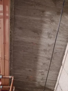

The hearth itself is 3 inch granite slabs. There is not 'extension' as of yet. I do not know what is underneath those slabs, but the attached pic is the hearth itself and two from underneath the hearth.
And that silvery surface in the basement pics appears to be some sort of plywood with a grey/silver paint. Is this good? Bad? I have no idea haha!
That looks like concrete that has had the plywood form removed.
Yes definitely concrete with the imprint of the wood forms it is done right
