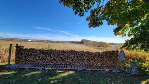

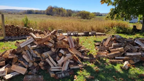

You can't get that to dry for three years in Ottawa? Really? Ottawa doesn't make my brain say 'rainy' when I think of it. Cold winters I bet but most likely hot dry summers no? What Mc % are you going for?
I stacked this cord today. South facing, loads of sun and very breezy in both north and southerly winds. The optimum spot. We'll see how green this is next fall. Its very green now. Another row will go in front.
