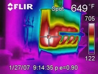

Well I may end up cutting down some of my wood supply after all. It feels like I've suddenly discovered the "sweet spot" of this stove. Last night and this morning, three 4-5" pinon rounds 9" long gives 2 hours of 550-600 degree burn. No hot spots or takeoffs, just a nice, smooth, consistent slow burn, perfectly clean out the chimney. It's an incredible amount of heat from very little wood.
It must be said that this isn't possible without the adjustable secondary air control that I've added, but that is a subject for a thread of it's own.
It must also be said that it's possible that those of you burning hardwood would not have to go through these gyrations to get a nice slow burn.
