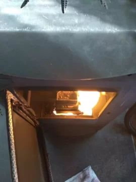

I have some different bags in my stash that I am going to try. I filled the stove already with the bad batch which I am trying to get through so I don't have to dig them out. The stove has been on since 530 and it's burning but not perfect. Stove chow are the pellets that are not working. I was thinking about mixing them if I get the stove to stay on.
I finally had to shut the stove off because this is the way the pellets are burning. The ash pan is filled with unburned pellets.

Stove chows generally aren't so bad, they are more ashy than some others and you might need to scrape the pot more frequently. And or clean the stove more frequently. But they should burn fine and they should heat fine unless they're damaged..
So you have pellets being blown out of the burnpot, is that correct.
