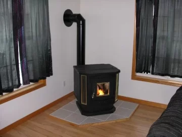

I must have got lucky, my E has been good.....heats my 1800sqft ranch very well. Ive burned 2.5 tons of penningtons, maybe20 gallons of oil. If it wasnt for this forum,id probaly sound like the frustated one. We have 10-20 below nites all the time, and this stove has been up to the task.....did start burning crappy after about 2 tons but the leafblower trick put a end that issue. Had so much fun doing that to my stove i went and cleaned out a few of my buddies stoves....will have to keep notching this leafblower and see how long it lasts...
