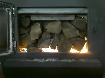

Here is a typical load in my BK Princess Insert. On the bottom there are 2 layers placed E/W. All but 2 pieces fit today, I can usually get the whole milk crate full in. There is 2-3" of ash/coals/nails in the stove. I'll reload in 10-12 hours running the thermostat at 2.5 dots (Insert has dots, not numbers), fan at 50%. The stovetop will be around 400 degrees most of the burn.
if that was any other stove, i'd be scared to death. gotta love the control of the bk.

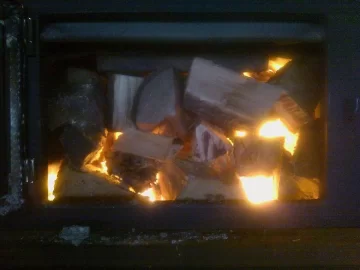

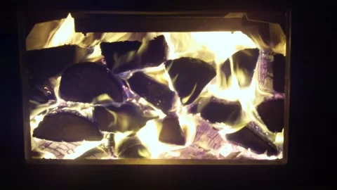

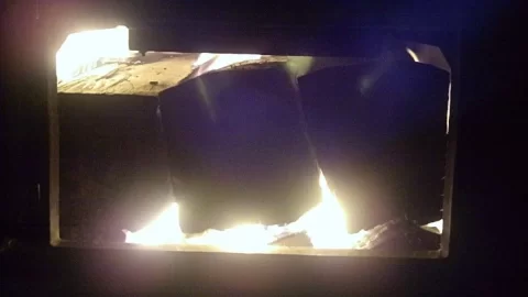

Full loads vary depending on the weather for me.

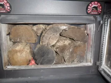

Last night's load. Had 400 degree temp at 13 hours. Hit about 5 degrees last night. Season 6 with the Summit and getting better every year. Well I suppose I am improving.

Hogz i like the dual thermos, looks like rpm and speedo ......

That's an impressive 13 hr temp. What was your peak temp and what's the usable cuft in that summit.

Not a Vista, It is the Summit.
The usable firebox, I have never measured. I do load her up to the bottom of the baffle usually for overnight.
Lately been full loads all White Oak. The larger the pcs and the tighter you pack it, the longer the burn.
Peak temp is usually about 750 while the nasties are burning off. Sometimes lower if really large pcs. But on a full load with little air space, it will slowly work its way to that.
Usually settles in at about 600 or 650ish. then spends a few hours at each plateau on the way down.
For my system, it is truly what wood, the size and how tightly you pack it, that affects temp rise & fall, and length of burn time.
I find the two thermos helpful in a few things. To monitor temps on both sides, they also tell me that they are fairly accurate as they end up at the same temps when everything is steadied. And does sort of balance the look out.

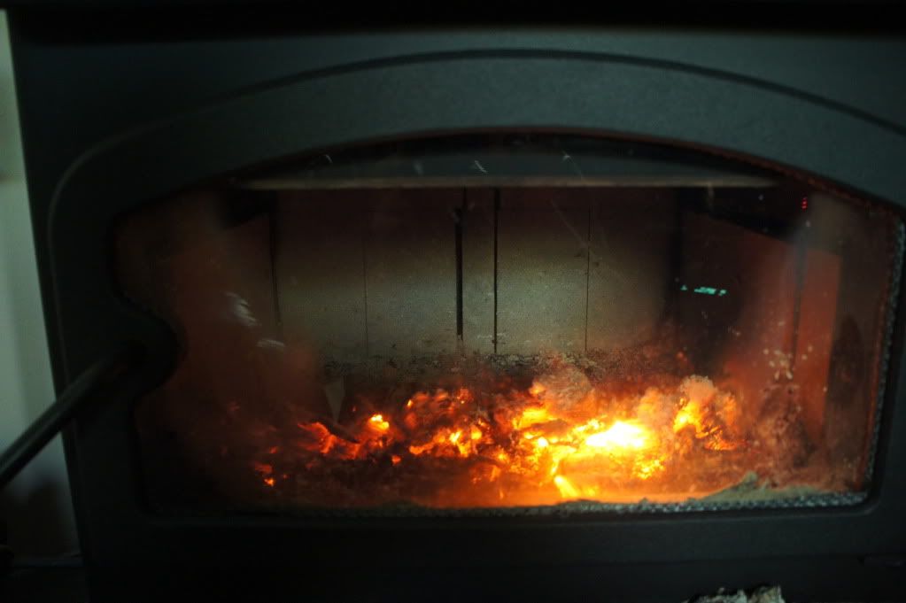

I think this picture was an experiment when I tried coals on the right instead of front. It seemed to me that side of my stove took off quicker, even though it is opposite latch side, so I thought I would "cigar" burn from right to left. Think it got me about the same results as coals in front.
That's a beautiful stove...
