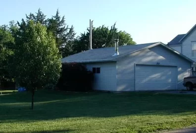

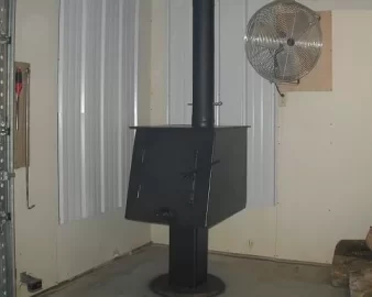

When we moved here we bought our new 32'X35' 1120 sq ft. "Garage" and it came with a detached 1800 sq ft house , ha . Put a wood stove in it , stove is set up like code to a house would be . More of a shop than a garage , bathroom , TV ect... All Gas , Kerosene and such are not stored in the garage/shop and the cars , trucks & suv's sit out side. The motorcycle sits in its own shed.

Good grief! Here I was sitting so proud of my 28' X 28' garage. Now I have to tear it down and start over.
