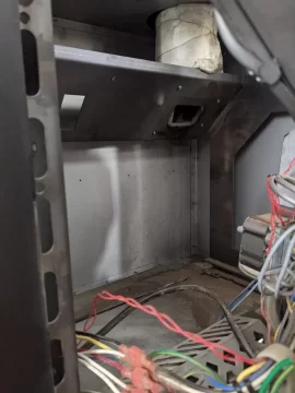

Heres a picture of "behind the pellet stove" haha which is im sure not what youre looking for or talking about. So ill have to disassemble it and see if there is a model number built into it somewhere? Or go back to the original building company and see if they have information on what they were installing at the time?
The model is of the burning device no? Not the built structure around it (brick and steel) correct? Or is it the materials it is built with?

It looks like a gutted gas insert. That is not suitable for a wood insert installation. It would need a complete replacement or if the area is wide enough, it might be possible to convert this area into an alcove with a freestanding wood stove.

I think the term you are looking for is hearth. The brick is most likely just a facade. I don't see any indication that this is a brick fireplace. It looks like a shallow 2x4 framed bumpout for a gas insert. One can not install a wood insert into this structure. It would not meet the safety or clearance requirements for a wood insert.
I can't say how the wood stove pictured was installed. This may be a European installation. In the US, this installation would need to be entirely non-combustible, aka in a masonry fireplace or eqivalent. This is not what you have. If the current chase is only 12" deep then it's possible that the current fireplace enclosure (chase) would be too shallow to accommodate all the clearance requirements for an alcove installation. The stove, the connecting stovepipe, and the chimney pipe all have clearance requirements that have to be honored. Given the shallow nature of the chase the first thing to check is whether a chimney pipe would have proper clearances. It would need at least 12". Does the chase (the outdoor bumpout) continue to above the roofline? What is the inside dimension of this chase above the pellet stove?

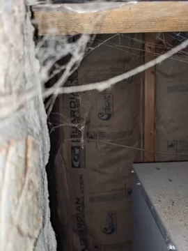

Turns out easy enough bubble for you guys to burst haha...but thats why I came to a forum like this. Peeled the hearth back enough to slip my phone down in it and snap a picture...you nailed it @begreen. Guess Im SOL then, just have to stick to bonfires outback for burning wood.
