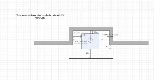

Very good resources...thanks! This is going to be a newly framed chase (which I am building) that is replacing the existing bump out where the useless propane insert currently resides. I have attached the sketch of the chase and the alcove clearances so y'all can tell what I am planning.

Good start in planning. You can use a regular ceiling support box instead of a cathedral ceiling support at the bottom of the chimney pipe. Then use double-wall stove pipe to connect the stove. Which Blaze King stove are the clearances in the diagram for?

So far looking good. The alcove ceiling will need to be at least 49" above the stove top. Will the stove have the fan kit?
When building your alcove and heath I would recommend going at least a couple inches past minimum required. Especially on the hearth it is nice to have a littl extra space there. And you dont wat you stove to tight in the opening either it just makes it hard to work on.
Yes on the fan kit and side shields (required for alcove application), and the ceiling of the alcove will be 8.5' above the hearth; the ceiling in that room is 9.5'
