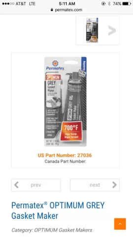

What about this?

I use the Permatex High temp Copper. At 700 degrees rated, gasket maker. I just took a gasket out I did 5 years ago with it. It was soft and pliable. It stuck well to the door. It scraped out, easily with a screw driver.
I had the side door off and the door burn plate off to do the gasket. There is a insulation blanket under the plate. I had a new piece of insulation. I used the permatex the glue it to the burn plate. That will have some extreme heat on it. I'll look at it after this season.
