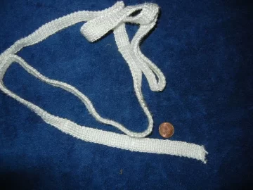

Here's what I did once and it worked out great. I took a piece of self adhesive flat stove gasket rope and applied it all around the mating surface between the blower and housing. Snugged it up and good to go. Lasted for years and never once leaked.
I have used flat rope and adhesive to replace these type of gaskets and will last for years. Takes a bit of time to allow adhesive to setup with clamps-clothes pins but not having to probably ever doing it again is well worth it. Flat rope kit with adhesive is around $10

So, how do you make a cirlce out of this without it bunching up? do you cut 45's into it every bolt section? use one piece?

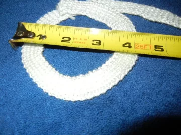

Its very loosely knit and very workable and easily works around a 4 inch or so circle without any pleats etc.[Hearth.com] Gaskets... how I loathe thee
Reactions: briansol
Not bad :)
If i cut the notches for the bolt circle, will it fray to pieces? use a lighter to 'seal' it back up after a cut?
If you use a liberal amount of adhesive that the kit has and let it fully setup then drill through after clamping on to a wood block should have minimum fraying or use an awl and ream a nice tight hole. Dust with some graphite and should not stick to mating surface.
