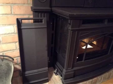

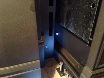

A couple of pics of damper with the side plate removed. And some pics of the side plate screws.

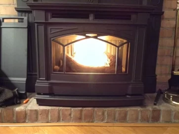

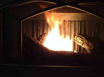

Flame looks great, and thanks for the pics. So did you ONLY have to remove the cast side piece? On my M55, the cast side plate mounts (hooks) onto another piece of sheet metal. Is that what you had to remove as well? I wonder if the case design is a bit different on the M55 vs the GCI60? I can easily pull my side cast plate off to see if I can locate the slide...But curious if you had to remove a "second" plate.
Just pulled the side, and it's the same. I can see the slide. On the M55 you don't have to remove any screws to pull the cast sides. They just lift off. Anyway, Thank you!

Yep, just had to remove the cast plate; that was it. I could probably access the slide without removing the plate, but it was much easier with it removed.
