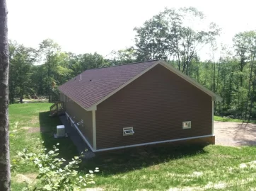

I've got a Generac 11kw. Been good so far. What ever brand you choose, put it on a raised pad. The snow here is already above the height of the generator. I have to make sure the intake, exhaust, and maintenance panel are clear.
I put a 1000 gallon tank in the ground. No fill-ups during the winter....
