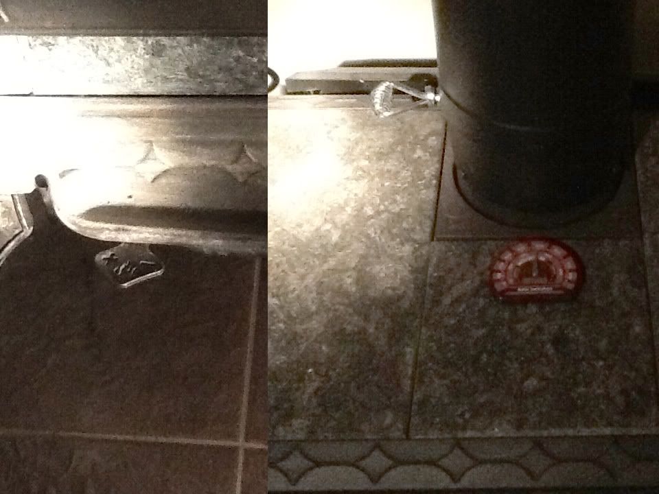

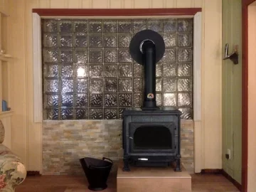

I included a picture of the stove and setup.

Ok here is my setup I have about 16' of double walled pipe on the outside of the house.
Inside the house the stove pipe is about 4' single wall standard black pipe with an elbow.
I have
No stove pipe damper on the inside here is what happens.
Using even very dry seasoned wood can I get the box hotter then 200deg barley stays at 170?
The side medal door will be 300 - 400 but the top and stone barely 180
The strange thing is I can raise the Temp of the box only if I open the ash draw
( as I was told Never to leave open ) can I get the stove pipe and the stove to 450 -500 deg and it feels like its actually heating and I then see the Re burner pipes inside working but as soon as I close the ash draw within a half hour, the box is 180 the stove pipe temp will be 325 deg ??
