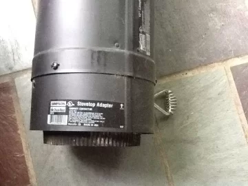

Funny. No damper but I tried to install one in my double wall simpson pipe and it turns out that the appliance adapter with a damper in it does not fit the collar. I would have to hack my double wall pipe and try to rig something that is not approved by Simpson.

Odd. I am using double wall pipe from Simpson as well and it fit. I wonder what the difference was in the outcome for the both of us?

I'm using double wall. Is a damper an option with this set-up? I sure hope so.
It should, as that is what I use as well. I am interested in Highbeams response to see what the difference is.

Oh no, that won't fit in the hearthstone cast iron collar. The crimped end is too small which allows for big time slop at the joint. The proper way to use double wall is to shove the bottom of the taper section right into the collar with no appliance adapter. I made a whole thread about this awhile back and the dealers verified that the appliance adapter in that photo is a no-go with a the hearthstone cast collar.
I really wanted it to work.
