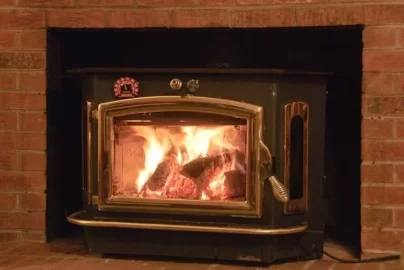

Depending on the insert I like the way they look without the surround. Mine is designed to be either a free standing or an insert and has the bay front. I painted the inside of the FP black and without the surround I'm convinced I get more heat coming from behind and around it. Very satisfied with my setup right now. [Hearth.com] Getting more heat out of an insert
Looks good Woodpile!
You would have to think it works better that way..run the blower much?

I run the blower most of the time but usually on low setting. It's pretty quiet and it's a trade off. Low volume of higher temp air or higher Vol of cooler temp air. Low keeps it plenty warm in here.
