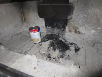

My setup is pretty easy to clean. I have the stove rear-vented into the fireplace with a tee, connected to a stainless liner. All I do is remove the cap on the bottom of the tee, attach a plastic bag to the open bottom of the tee, and brush down into the bag. I think I could clean from the bottom if I wanted to, but my one-story roof isn't too steep.
I brush the liner once a year; I get about a quart of stuff. There is a little bit of flaky stuff at the top 4' of the liner, where the flue gasses have cooled. Below that, all I see is soot, which I wouldn't expect to burn at all. I'm not too worried about a little flaky stuff at the top...I think it would be very hard to get enough heat up that high in the chimney to be able to ignite that.

For example here is one year of buildup in the 22' liner from my Jotul. I remove the baffle plate inside the stove and the flue empties right into the firebox. I put a soup can in there just for size reference.

My old stove would fill a 5 gallon bucket in a couple/few months.
