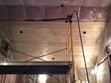

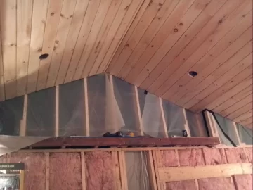

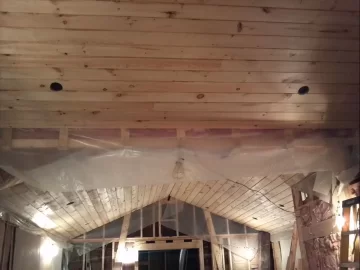

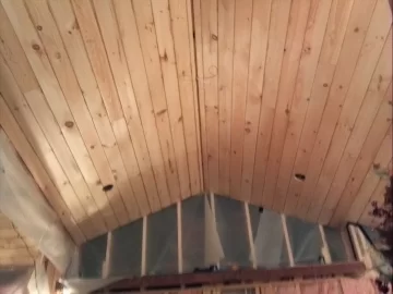

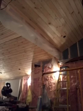

    We finished up the T&G just about a half hour ago........will do the millwork pieces later this weekend if the woodshop can have them ready for me by Saturday. Gonna do a big clean-out of that room the next several days, get the electrical up and running, and finish insulating a couple of open studs in the walls (left them open for some wiring that needed finished), will stain the ceilings this weekend also.
    Busy, busy busy!!

    It's a weird feeling when you close up the walls. With just the insulation the room is so quiet, but once the walls go up it gets loud.

    Had the MP3 player cranking in there, and when you step outside you cannot hear it at all anymore......yes, that insulation really dampens sound out!

    Looks good Scotty, sure will be nice once everything is done.

    My sister-in-law used to always say "that makes me tired just looking at it". It was usually a project I was doing that she would be commenting on. Well, now it's my turn. Scotty, that makes me glad that you are doing this and not me. I need to take a rest just looking at all you've accomplished. Lookin' good dude.

    looks great, we had done one very similiar in a million dollar olde english style hunting lodge. instead of staining it we cleared it with a tint of color in the clear. along with the natural color change from aging it looked great when done, it will also save a step. the problem with something that big and staining is color variations, and overlaps from when you have to move scaffolding. working by yourself will make it tough to avoid. I have some pics if I can find them and scan them I will, back when we still used film in cameras.
    Tuscany plaster on the walls, a few elk horn chandiliers and large random slate floor you will be over in England................
