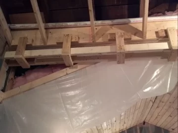

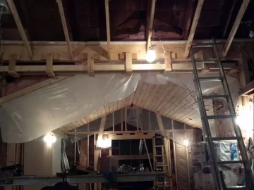

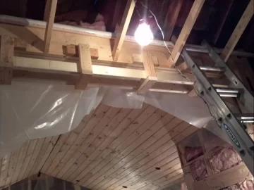

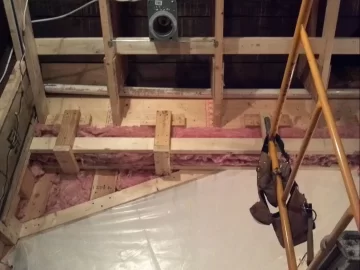

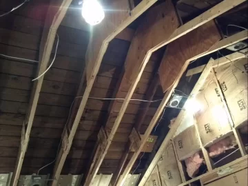

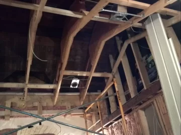

    Been slaving away at quite a few things the past couple weeks since I started the ceiling in my two-part living room. Finally got the structural beam "boxed in" for the faux barnwood beam, will insulate that this evening and get the ceiling started on that side this weekend. I'm really looking forward for this damm ceiling to be done!
    Pic of the roof rafters that were converted to scissor trusses, and a couple of pics of the faux barnwood beam framework ..

    You're right, PD.....it is a funny word, but it sounds a little classier than "fake" beam....lol.. There actually IS a real beam above it, but I had to make framework for the barnwood to mount to. I'll do the beam when I get the ceiling done, don't worry......I'll post plenty o' pics for ya!;)

    I'm like'n what I am see'in. That should be super sharp when finished. I love the warmth that interior wood brings to a home.

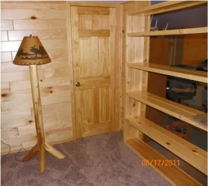

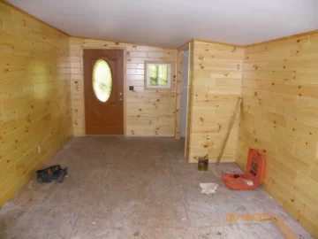

    Love the knotty pine. Here is a little bit of ours from last year.

    Real nice Dennis.
    Is that pass through shelving?
    Part of the addition?
  13. Backwoods Savage
    Backwoods Savage
    Feb 14, 2007
    27,815
    7,369
    Michigan
    Yes. Wife really wanted that. I really didn't but gave in. It is working out okay.

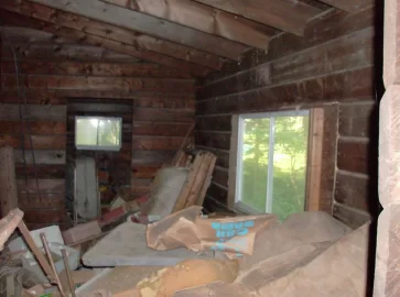

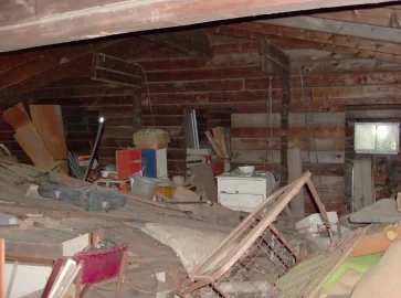

    I'll be doing the same in this log cabin I just bought.
    This place was built in 1972, and NEVER finished. I will be cutting a ridge vent and shingling first, then insulate the rafter spaces with air troughs for vent space above the insulation. I like to add strips ACROSS the rafters and put sheets of silver backed foam board on the studs tightly between the added strips. I'll attach the tounge and grove finished ceiling boards WITH the rafters in a vertical pattern instead of ACROSS the rafters. I like the taller appearance it gives a cathedral type ceiling.

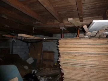

    This log home was brought from north of the Artic Circle from Finland, so I'm keeping it original the way they are built there with only 6 foot doorways and low windows since the sun never gets very high on the horizon. It will be a while to start the ceiling. The entire home is full of building materials and logs from building 5 other homes like in here in the states. "Full" of building materials is an understatement. 700 plus sheets of plywood in the basement stacked to the floor joists saved the floor from colapse for 36 years ! Had to stabilize the building before I could start unloading it. Below is one of 3 stacks of plywood I jacked the beams back up with. The posts will stay after unloading the floor above. Ceiling will be next spring.

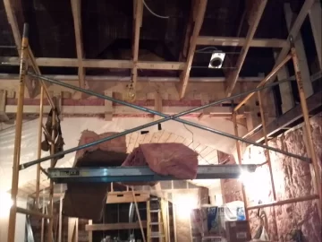

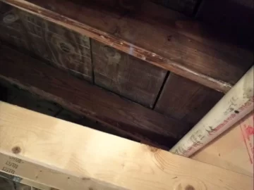

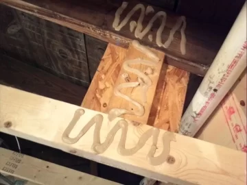

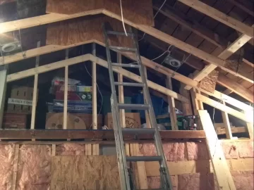

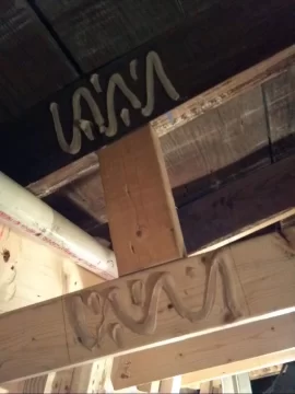

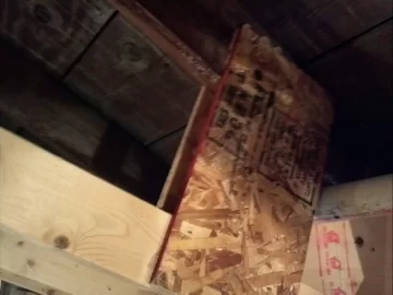

    Finally making some progress on the second stage of my knotty pine ceiling. Got the beam framework complete, finished framing the open gable in the loft end, got all the electrical roughed in, an insulated the truss gussets and beam. Also made struts for each truss to add rigidity to each rafter. Should have most of the insulation done by Saturday afternoon, barring any other unforeseen circumstances......

    There's enough "gusset" material in there that I could build cabinet carcases for my kitchen, AND laundry, AND bathroom.;lol
    Maybe the shop too. ;)
    ScotO likes this.
  24. ScotO
    ScotO
    Guest 2.
    I didn't have access to gang nails (like the ones they use to build trusses). I priced some of those gang nails on the internet and almost threw up! They aint cheap. Anyway, since I basically built a truss ouf of every original rafter on both ceilings, I went the extra step and built those gussets.......they are glued and nailed with 8D nails......the OVERKILL WAY!:cool: They also helped me level out the ceiling to near perfect, which without those gussets it would have had a couple of nice waves in it. Tonight I'll be swimming in insulation.......I just cannot WAIT to be out there in an hour or so......
