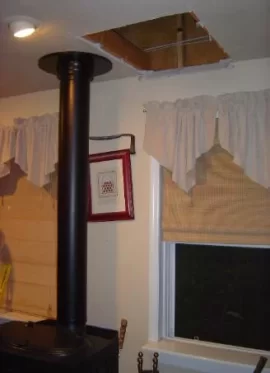

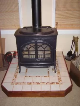

$350 for that stove. wow! congrats. was it professionally installed. looks great. i would be curious about the clearances on those curtains. im sure others will chime in. stay warm...

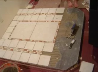

Yep it cooks alright!! Wanted a smaller one but couldn't pass this up. House is about 80f in the back living room, 72f in the front living room with a moderate load. I keep the two windows cracked. The pics are from when I was installing the stove. The stove has a heat shield on it. Clearances are 13" from shield to wall, 9" clearance from sides to edge of hearth, 19" from front to edge. Curtains are aprox 17" diagnol and made out of bamboo.

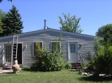

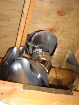

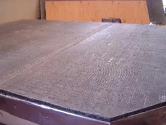

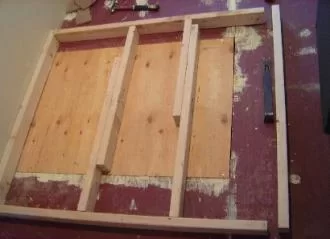

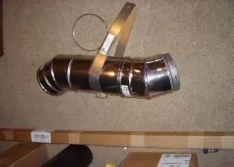

The install is not pro, I did it myself. Supported the crawl space with 4x4's. Framed out the hearth ( 2"dead air, 3/4" plywood, sheet metal, 1/2" cement board, 1/2" mortor, tile, heat resistant grout). Used Simpson Duravent double wall interior pipe to flat support kit, to a 12" stainless pipe to offset 30 degree to 6" to 30 degree (to negotiate a rafter), to 46" to cap. Had it inspected without a hitch.

How were the hearth pad dimensions and construction determined? Are they from the manual? Does the stove have a bottom shield on it as well?
Yep, the guy who I brought it from had the original owners / install manual (it's a '93 model), the reciept, the warranty which was never filed and the brochure from that year. I made the hearth two inches over the required specs because I like my house not on fire, LOL.
I got the specs from the manual and also checked local codes with the fire marshal just to be sure. The stove doesn't have a bottom heat shield but the r-value of the hearth does not require one. I might put one on just to be safe, what do you think?
