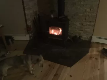

My craftsbury is small but is the primary heat source for my house. 1500 sf open plan downstairs with 800sf of bedrooms upstairs with a large stair opening.
  • [Hearth.com] Good stove with a small footprint
