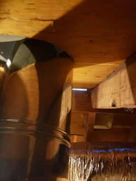

("hijacking" this thread because my case is similar and does not really warrant its own thread.)
So, my oil boiler chimney runs through a chase with walls (counter clockwise) to the outside wall of our home, our bedroom, a closet (from which the chase was subtracted), and a bathroom. From touching the walls in my bedroom, comparing the outside wall in our bedroom with the wall to the chase, I deduced there was no insulation on those internal chase walls. As the chimney chase is open to the attic (I insulated up there), and the attic is open to the outside, all the cold air in winter sinks down there and stays... Bathroom wall section condenses up easily too.
So I opened it up now with the intention of insulating the walls - going to use some glass fiber I have left over, but will put wood strips across to avoid it sagging down against the chimney.
The roof was replaced two years ago (after I insulated the attic). Access to the chimney from the attic is nearly impossible because of the slope of the roof.
Now, with a better view up along the chimney, see what I see?
The clearances to the studs are all good, but that shield foil is touching the chimney. (The black stuff appears to be close in the pic, but from looking with my eyes it seems to be ok.)
This is a very reputable, established roofing company. They already made other mistakes near the gutters, and were sloppy (with drip edges missing 2" sections near corners of the roof, and one 10 ft section having no drip edge at all), and now this. Hugely disappointed in them.
I also found pieces of shingles in the box where the chimney goes through the floor to the basement where the boiler is. I.e. solid oil right in the clearance zone.
Pisses me off.
Going to call them back. Again.

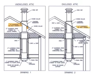

This would be covered under the International Residential Code:
I went through that, but don't see a (general) clearance for a class A chimney there?
Moreover, my town code says to go by the NFPA (a class A IS a factory fabricated chimney, right?):
[Hearth.com] Got a new roof put on last week...
Of course the mfg instructions are clear, but I believe there is somewhere a code where it mentions 2"? Or does all code say "go with the mfg"?
(Is there ANY class A that can do less than 1.5"?
Because my chimney says it can be 1.5" if ALL components of the chimney are labeled "MAX", otherwise 2". This section is, but I don't know about all components as I'm not that acrobatic in the chase... So I'm going with 2".)
R1005.1 of your page says of course "go with mfg instructions" for listed chimneys (thus applying here).
He gave me this pic (of uncertain origin, so of no jurisdiction...):

Okay, so "code" basically says nothing about a general rule. Instead, they defer to mfg instructions coming with (listed) systems.
Is that correct?
Yes, Metal-Fab Temp/Guard Max is listed at 1.5" clearance.
Exactly what is the light grey stuff that is touching the class A pipe? Is that the only issue?
(yes, 1.5" minimum, only if the whole system is listed. Otherwise 2". So for me it's 2" as I can't confirm the rest of the system.)
The grey stuff is white plastic foil. The black stuff is black (asphalt impregnated) woven stuff. One of the two is the ice and water barrier. I don't know what the other is.
Yes that is the only issue.
I thought of mounting a knife on a broomstick and trying to cut it away myself from the bottom of the chase. I can't reach it in the attic. (It's the low end of the roof, and when I insulated there I was not able to get far enough there to really work on something like this, though I could shove insulation there, while keeping an air channel open from the soffit along the plywood up, and I installed some sheet metal around the opening to prevent insulation from sagging in. Ugly, because hard to reach, but functional.) But I'd still have to tear the last part as it's flexible, risking creating tears further under the shingles - and that's not good.
So, yes, that's the only issue, but they have to fix it, from the roof side.
Thanks, it wasn't clear from the picture. I suspected an ice barrier, but wasn't sure. That definitely sucks and clearly it has to be remedied. I am wondering if the chimney pipe can be removed from the top and then the roofing material cut away to the perimeter of the cone from topside?
That is what I hope too.
