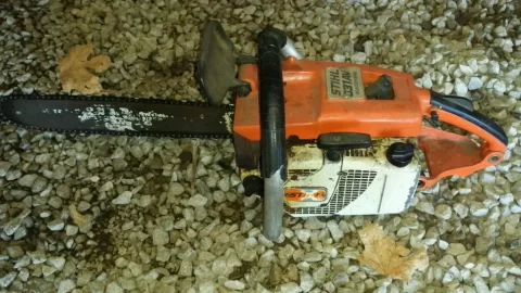

Finally found an app to resize my photos. Here is my new to me old beast
