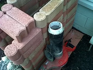

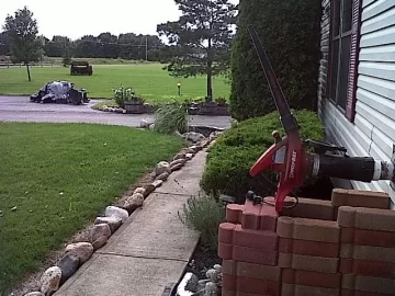

I have pavers stacked up beside the flue. When doing my cleaning, I arrange a few of them to rest it on and run it the entire time I clean the stove. Also, depending on your model and flue application, you may need to buy a PVC adapter. I used a 4" to 3". I cut the vacuum side of the leafblower down till I got a good fit and then used liquid nails to seal/hold it together. Some people have been able to adapt the leafblower without an adapter. Every model and stove set-up is a little different, but this is what I had to do. Hope this helps.

DexterDay said:
Yes. Its electric. I am pretty sure that almost everyone on here uses an electric model.
yeah, dex- i wasn't even thinking how cumbersome a gas blower would be to use for this app. they're just the only thing comes to mind when i think leaf blower. durr!
i like the idea of the rubber plumbing fitting and clamps some folks have mentioned using.
thanks for the pics.
