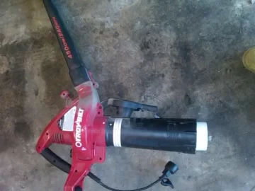

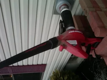

Made mine a couple years ago after reading koosers post. And it still is holding up..Used a section of pipe stuffed into the cutoff suction tube and some electrical wrap. Does wonders for my stove. The first time I used it was the wildest(black soot), now the soot is mostly grayish.

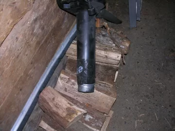

I used a 4" to 3 1/2" PVC reducer. Cut down the vacuum tube, till the 4" end fit snug. A little Liquid Nails around the inside and outside, to seal and affix to the unit. Not an expensive set up. The best tool to have in your bag of pellet tricks!
:: Edit... I need to learn how to rotate pics. They are right side up when I'm posting them. Sorry if you get a kink in your neck ::

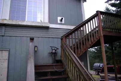

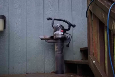

Ok, the weather is dreadful outside but I got out the new leaf blower and machined the adapter piece and got it all set to go.
Cleaned the stove in the usual manner and then hooked the sucker up to the pipe.
OMG the crap that came out of that thing was horrific. Its no wonder that the door glass
was smoking up fairly quick and the fire was not its usual lively sort.
Tossed a fire right back in the little critter and OHHHHHH MY what a difference.
Leaf blowers should be a part of the stove maintenance kit from the factory me thinks.
200 MPH wind sure has a way of getting soot a moooooooooving.
Had a family member watch the blades on the exhaust fan, and it was really a haulin I am told.
I am looking forward to using the blower on the Big Whitfield in the near future.
Hmmmm just thought about something.
I ya find that a batch of beeeeeeees has moved into the pipe, just hook the blower up and suck their Butts out.
Not sure that they would like the trip through the fan though.
Here is a couple pix of things this morning.
The 45 angle cap is off the vent in the pix.
Its a TORO blower, cheapy but it works well.
